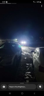

I only have halogen headlights on my truck and these are brighter than my low beams and fogs but not quite as bright as the high beam and low beam together. They throw a very nice flood beam pattern out to the side up high and down low. I'm really impressed how much light they throw. They were definitely worth the money in my opinion I hope they last. Wiring install was really simple with the harness they came with it took maybe 20 minutes to wire it all up. I thought I had another picture from the cab but here is one from about 200' away.
