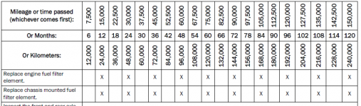

Any chance you could link to where you took that capture from?

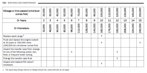

The manual I downloaded from Mopar.com did not have a complete service schedule. And the intervals are 20,000 miles.
Here are the 2 pages under "Service and Maintenance" from the manual I downloaded from this link:
Which downloaded this doc:
I guess the 2019 manual is different.
But given your'e showing a schedule that includes spark plugs, I would imagine that's the gas engine pages, not the diesel.
It's on Pg 388 of the 2020 Owner's manual PDF I have.
2020 Owners manual P108233_20_DJD2_OM_EN_USC_DIGITAL.pdf

I scrubbed the 2019 manual and it does NOT include any maintenance plan outside of what I posted above.
The only mention of the word "diesel" is in the fuses section.
The cover page says RAM 2500/3500, so I fully expect it to have all the relevant info. I don't know if I am missing something or if it is a terrible mistake by them.
