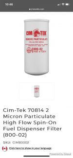

Fuel stations run a 2micron filter on the pumps and the truck is 2 microns as well
Wrong and wrong ^
Specs on OEM filter says 2 microns for the 19+ the older ones were 5micron outer layer and 3micron inner layer and the filters on the pumps are 2 microns at all the shell stations family friends own from what they said it was the standard filtering

This is what most most fuel stations run around here
