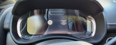

I have a new 2024 3500 Ltd HO. My Digital gauge cluster and the u connect system lights turn on and off every 10 seconds when the truck is off, locked and the keys are 50 feet away. My battery is dead every day. The gauge cluster says push button to start almost as if it thinks you are sitting in the seat about to start it. Has anyone come across this issue? I'm away on vacation and miles from home and from the dealership. Any help would be much appreciated!

Hi, no the dealer couldn't find any codes and couldn't confirm why it was happening. Right now it's not happening l, it appears to have went away for now. Let me know what you find out, maybe try the dealership.
