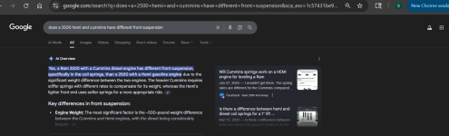

Hello all, I have a 21 2500 6.4, I'm going to upgrade to one with a 6.7, may even go with a 3500, I've tried doing some research and thought I would ask on here, are there difference's in suspension and rear ends from the Hemi 2500, and the Cummins 2500? I thought maybe it might have a heavier rear end since there is more pulling power with the Cummins, and maybe some difference's in suspension.
The front coils are heavier duty to support the weight of the Cummins. Rear coils are the same for the 2500.
