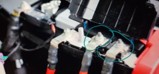

Interesting, I’ve never seen that type of fuse before. Do you know what size those factory fuses are?So just to be clear, the extra stud on that battery post can have a stackable fuse added to it then place a eyelet on top of it as was done with the two to the right. Look at the circles in the pic I attached, the little black square box under the eyelet is a Z case fuse and they are available in multiple ranges. It may not give you two circuit breakers but at least it will give you an easy spot to grab one power source.
Here is a link to Waytek for an example of the fuses https://www.waytekwire.com/item/45592/Littelfuse-ZCASE-Single-Mega-Starter/
Looking at the picture you posted the square fuse to the left looks like it says 200 amps, but I'm not sure what the factory ones are. Each fuse will typically be different depending upon what is on that circuit. To size it for what you were doing you would need to know the current draw. What are you trying to use those breakers for and what are you hooking up? The current rating will be printed on the side of the fuse typicallyInteresting, I’ve never seen that type of fuse before. Do you know what size those factory fuses are?
