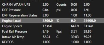

Last November I updated the software on my CTS3 and engine load went from working normal (0-100%) to erroneous readings from (0-25K%). I have been working with Edge on this error for over 8 months. Multiple software updates and I've even mailed my CT3 to them twice, and it was replaced once.
Today I got a loaner CTS2 from them and it works normally.
Is anyone else using a CTS3 with current software having issues with engine load?
This is at idle.
When I had mine on the 2019 thats what it would read. I thought it was normal as it was always showing that value.
The wrong reading?
It was exactly what is on your screen just different location. It always read that way since I plugged it in, figured it was "diesel" talk on the load. Im not well versed in the diesel world so forgive me.

I noticed in your other thread that your load was reading 1000%, so it seems you have the same issue.
I’ve gotten the best results from Kloe at Edge, PM me if you want her contact info so you can let her know you have the same issue.

Mine runs all the way up to like 18,000 or so (or was it 1800? lol). Looks like the same issue as others.

Well checked the logs it was a min of 0 and a max of 25600% lol.

Reporting back in on this, picked up a 2013 and the load is the right % on it with the same CTS3.
