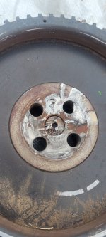

Hi my name is Ryan and I have a 2021 ram 5500 with 163,000 miles on it. The crank pulley just breaks off while I was driving. No signs of anything wrong with it. Dealership is saying after 3 months of sitting that the extended warranty company won't pay for it because they did the bolts failed. I find that hard to believe because they did the bolts were so in the holes and tight. They are wanting $30,000 to fix this. Does any one have any advice for me please? My business went under because of this and it's getting worse.

Did the crank snap off or just the bolts sheared? 30,000$ sounds like they want to put a new engine in it plus about 10 grand in labour?
Sorry, when the crank broke, it hit the motor and put a hole in the block.

From the sounds if it your crank broke resulting in your crank bolt snapping off. I cant see how shearing the pulley off would break the crank itself. Also, very disappointed to see the warranty will not cover the repair...... assuming truck is 100% stock. How long are the extended warranties good for mileage wise?
I also have a 21 ram 5500 but my harmonic balancer bolts just broke off leveling studs in crank . Engine still runs but shows no oil pressure. The extended warranty was also denied because I did my own oil changes! My advice is never buy extended warranty! The language is always is always aimed at finding a way to deny the service claim! And only to make sure you take vehicle to dealer to pay bloated prices .this has happened to me 2 times with my 5500 and 3 other times with other vehicles!

No thats not true at all engine parts internal and external are covered the balancer is not an accessory
I don’t really see why losing your dampener would make you loose oil pressure.. the 2 seem unrelated.
