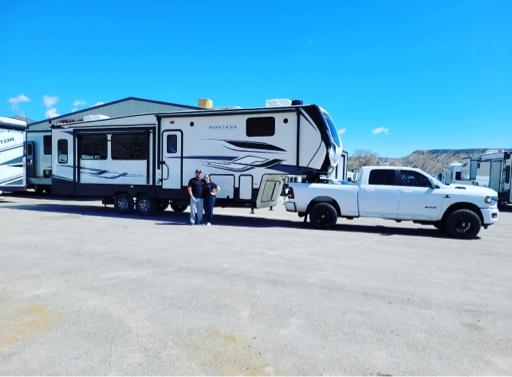

I have a 2020 2500 and just bought a 5ther with a 2400lbs tongue weight. The coils handle the weight extremely well. My 2500 sags less than my brother in laws 3500 Duramax, and my tongue weight is heavier than his. I was highly impressed with my 2500 suspension. 5 hours trip with this thing and I will NOT be getting bag, don’t need them.

Oh shizzzz. Y’all are right. I was just going off the website haha. It’s 2410 payload. And my 5th wheel is 2340 hitch weight. I got plenty to spare hahaha.

I’ll just add some bags to help with payload. Crazy thing is, my truck felt nowhere near its capacity. I felt like I could put another 500-1000lbs in the bed. It pull my 5th wheel with ease and the ride was really comfortable. My dry weight of the 5er is 11,890lbs.
thats because the “Payload” numbers are for registration purposes the AXLE GWR is what you load by and that is 12040LBS not the 10k registration (payload) weight
