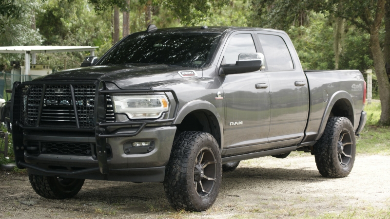

I recently purchased a '19 2500 CTD it came with a spacer level already on it but I'm not a fan of these. I had one on my 1500 and quickly replaced them with something else.
Anyone have experience with the Cognito 3 inch level?
I am thinking of pairing this with a 1" or 2" rear lift coil from Carli to keep some rake.

I've seen the name pop up a couple times in the past few months but honestly never heard of them before that. Something they don't mention in that link is if it is for diesel or gas? In the compatibility chart they list Power wagon which is obviously gas and that would be a concern because it shouldn't be the same rate/weight springs for a diesel that weighs much more.
They have been around for some time. Lots of people use them.
Just give them a call and I'm sure they can steer you in the right direction of what you need.
Where did you find a 2” carli rear coil?

That changes everything for me, thank you.
On their website they only have a 1” option and they say it provides 1/2”-1” lift
