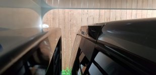

Just got a ‘22 Ram 5500 with CM SK bed. Drove home before realizing the CHMSL is lined up directly with the top bar of headache rack! It’s useless and no amount of offered adjusting helps. Is there any sort of relocation kit or does the CM SK bed need to come up with spacers? I’m a total noob so any info greatly appreciated.

Sounds like the CM roll bar needs to be modified. i would not space the bed up any expecially if you tow a GN with it. I would contact CM and the bed installer to see what they can do for you
Local CM dealer suggested they add 2x3 wood to raise bed up. CM wont answer or return calls or emails!
