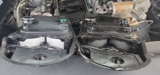

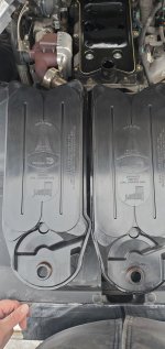

Today amongst other things I replaced my CCV. I know it's only supposed to be at 75k, but I like to be ahead of the schedule as much as I can. Here's some pictures in case you guys were wondering what it may look like. Took about 30 minutes and I took my time, the rear screws were inconvenient, but nothing out of this world.
This is where I got it, a fair price, I bought two to have another one on hand. Genuine fleetguard.
and here's my pictures.
