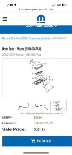

So went to install my back Friday deal monster ram on my 14 2500. Low and behold I snapped the stupid thin plastic on this part.
It’s comes from the CCV down to just next to the CP3. Called the dealer and ordered the broken hose. Besides my anger for whatever lame person decided to use thin stupid molded plastic. I yanked the rest of the pieces out. May have been glued in by factory I don’t know. Seems to be in a tight spot. Before I go crazy thinking about how I’m getting it back together. Am I missing something? It looks like everything just slips on there are no clamps, but with my luck it can’t be that easy. Any tips would help me sleep at night. Thanks guys.
That looks like it's the oil drain from the crankcase filter, it should just push on to the nipples

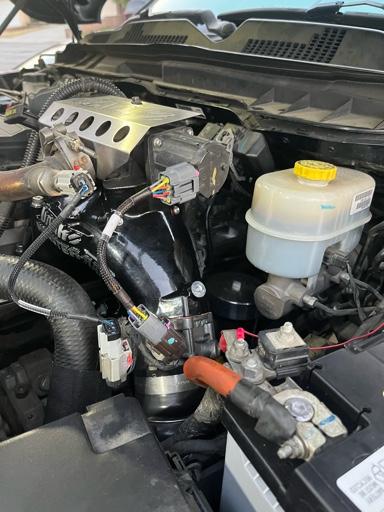

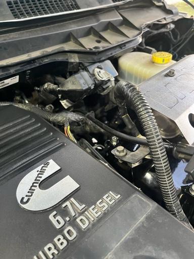

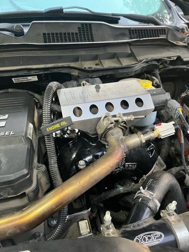

Update. Dealer gave me a replacement part that was not manufactured correctly, the y connection was upside down. Drove an hour and a half for a dealer that had it. Finished the install. Cranked up the truck and it looks like the 6 fuel line is leaking. I knew I shouldn’t have put the sound foam on. Now back to removing some parts to get the foam off to check all the lines. I have to get this done by tomorrow or else we have to cancel vacation. I am kicking myself in the ass for even doing all this. I live in so cal hardly ever use the grid heater, but paranoia got the best of me.
Had to remove the wheel well to get the hose back on.
Pulled the noise cover off the injector lines. Pain the the ass with everything back on. Tightened the last two fuel lines to 30 ft lbs again and ran the truck at idle for 4 min. No leaks. I can hear ticks that come and go from the injector lines not consistent and they fade as the truck warms up. Probably normal? I think that’s what the noise cover baffles. No CEL, going to do a Costco run in an hour so I’ll check again for leaks when I get back.
Alright gents, after an hour of driving around the wife and kids on errands today, no active leaks on the ground. I’ll let her sit over night and check tomorrow again. I’ll upload some pictures tomorrow of the final project. Now it’s time for a beer.

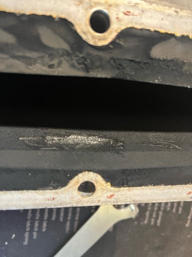

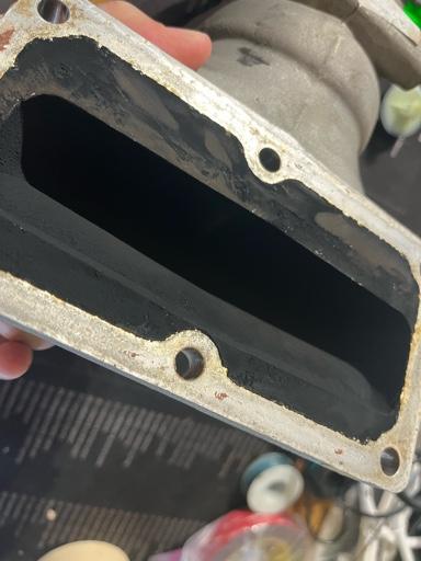

So how dirty, curdy, or caked up was the stock intake horn? Was like I see on all the YouTube videos?
Now there is the best question. The truck has almost 60k and it’s a 14 so the manual gets rid of the egr cleaning at I think was at 75k on 13’s. There wasn’t a caked on layer upon layer of soot. I’ll upload some picks of the old horn. I mean yea it has some but not anywhere near the pictures. But I have heard that some years the egr works more than others.
