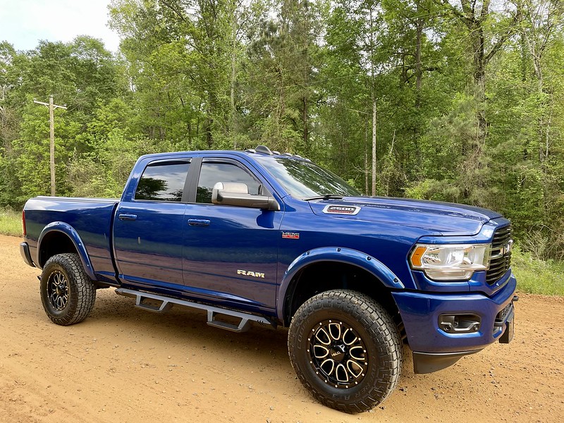

Decided to go for it. The ride seems to be a little better. The mpg doesn't seem much different so far, but need to hand calculate and would also like to the get mph calibrated. Love the looks.
