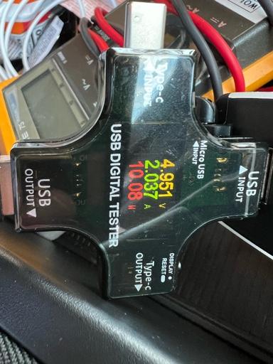

Mine too! I bought a usb port tester from Amazon and check it when I start the vehicle. If it’s below 5v iPhone will not charge. It is intermittent, have seen as low as 4.82v. Tried to get the dealer to fix it but they say it is okay (big surprise).

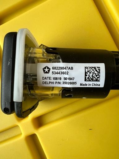

After 2 trips to the dealer, decided to fix it myself. Pulled the cupholder trim off (just pull up on it), there are two clips holding charging port in, used a screw driver to push down the top one. bottom one was tricky, pull off the little black cover and you can see it better, used a a 90degree Phillips screwdriver. With it out and disassembled I could see the voltage change when the charger was flexed. Ordrred a new 68229847AB on eBay for $9, back in business!
Pics are new to old, USB tool with iPhone plugged in now charging at 4.95V@2amps, new part, old defective part is last, date code shows 37th week of 21, during pandemic. New one is from 2019.
Note if I had to do it again it might be easier to pry off the black little hinged cover that says ‘USB’ and drill out the bottom clip.
Pics are new to old, now charging at 2amps, new part, old defective part is last, date code shows 37th week of 21, during pandemic. New one if from 2019.

It charges my iPhone at 5v @ 2amps = 10watts which is pretty good, enough to charge a iPad too.
