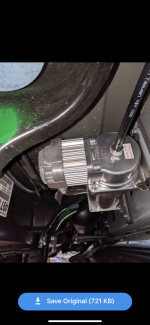

Looking into the Viair OBA, and wondering where you installed it? I know there is plenty of spaces where it can be mounted, but did you have to make any special brackets for everything to line up?
Here is what I am after, would appreciate if you have pics..
That’s exactly what I did and bought. Tank and compressor installed right below drivers side doors on side panels.
Perfect, that helps a bunch! Where did you get the brackets you used to mount the tank? I'm assuming the steps don't get on the way when they deploy?
Also, I see the compressor was screwed onto a metal sheet from the inside of the body? No issues there? Ive seen people drill on the frame of the truck (doesn't look like you did that) and that gets me a bit hesitant...
I love where you placed the fitting and gauge. I'm stealing your idea btw..
Lastly, is this pre-wired to the aux switches in the cabin?
