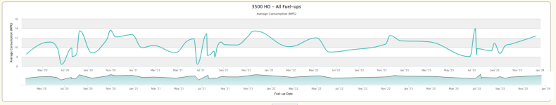

Crawler Hauler with 3k Pin Weight, Range of 70+ gallons of fuel, and 2500' of elevation change right out of town for every time I play keeps me in my current 3500 diesel.

Crawler Hauler with 3k Pin Weight, Range of 70+ gallons of fuel, and 3500' of elevation change right out of town for every time I play keeps me in my current 3500 diesel.

Cummins gets a whiff of a heavy trailer and it's 10MPG give or take a few.

My hemi doesn’t see teens now. Best was on a highway trip at 65 mph I got 16-17. Hasn’t since. Granted 37s hurt but still. My diesel’s around town were all 13 range and highway 16+++ easily at 80 mph
I towed a 6000lb trailer round trip through Utah mountains in a rented Laramie Cummins last month and averaged 9-10 MPG.
