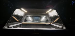

I have the ARE MX and I added some lights along the top... 5m roll of LED strip lighting... big box store for longer bolts.
Tied the wires into the cargo lights so they work exactly the same with the same switch.
Lights it up pretty well and they sit higher than the center which which sticks down a bit so no worries about being hit.
Nice! How exactly is the light attached it to the roof rail bolts? Is the led strip on piece of flat bar or something?

The LED strip (5m White LED Strip Light 2835 SMD from SuperBright LED) is attached to a flat aluminum stock (peel/stick).
I replaced the bolts (4 M6-1.0 x 30mm) holding the Yakima rack with longer bolts (and a generous amount of silicone).
Wires come back and snake around the cap frame, down the inside of the truck frame where I tied into the existing bed lights.
The bar is only attached at the front/back... didn't really feel the need for more... you can see the wires to the left (before I put them in a harness)

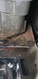

This is the wire I tapped into, this is looking towards the rear of the truck above bumper
