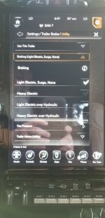

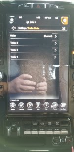

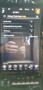

Hi, hooked our camper up to the 2500 for the first time today. I was setting up the trailer brakes a bit. On our 1500 silverado the brake gain was set at about 5 but with the 2500 I had it set for 8 and it still doesn't seem enough. I know all trucks/trailers aren't the same but does that sound right? What's your gain set at for towing your rigs for example?
In your setup, did you choose Light or Heavy Electric? I was told if you were pulling an empty trailer or a Light Electric use Light Electric, otherwise use Heavy Electric. With Heavy Electric you get more breaking but more wheel locking in an emergency panic stop if you set your gain to High.
P.S. Please excuse the ghost in the screen. LOL.

Oh, I didn't even notice there were those settings. I only thought it was the +/- gain buttons. I'll have to go back and re-check this. Camper weighs about 8k so I guess heavy braking? On my 1500 I had the brakes set up to just short of lockup when I used the brake slider. Thanks.
Each truck and trailer is different, I would go with Heavy Electric and then make adjustments from there if it were me.
