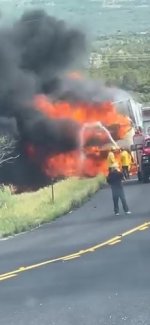

Photos below of a tractor trailer rig on fire in 50 yards from in front of our home's private road. This was in June 2024 due to brakes overheated. We were in Wyoming at Flaming Gorge. A neighbor sent a text message that my wife's phone somehow received. Due to this incident we drove home and have a portable Starlink for our phone service.
