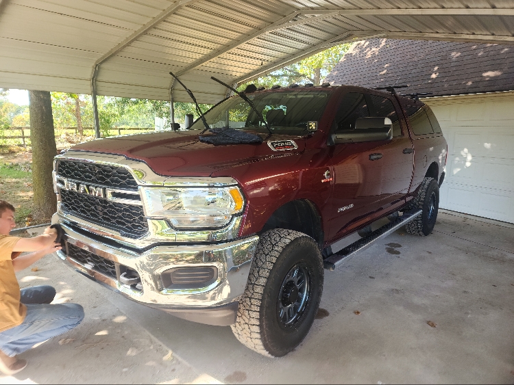

Posting here to determine how big of a rim tire package I can put on my truck without tires rubbing on radius arms. It's factory height at the moment but I will be doing a 2.5"-3" leveling kit in near future. Been looking at rims 20×12 8×6.50 with a back spacing of around -25mm. Tires 35x14.50. Is this to wide a tire or should the back space be more than -25mm? Any help would be appreciated.
Thuren Fab has a good article on tire/wheel suggestions.
Short answer: He suggestions +18mm to +25mm offset

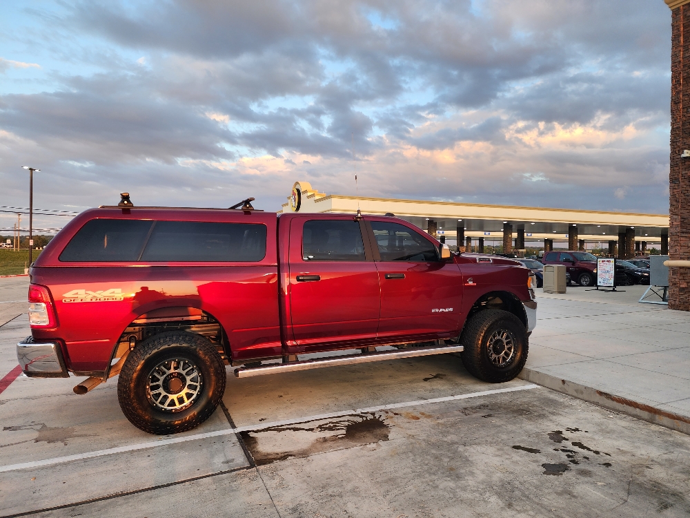

18x9.5 +18 offset
37x12.5
Carli 3.25" springs
Slight rub on sway bar at full lock. Would be better if the alignment guys actually centered the axle properly up front
Previous setup was 2.5" rough country spacer lift and same rubbing issue.
