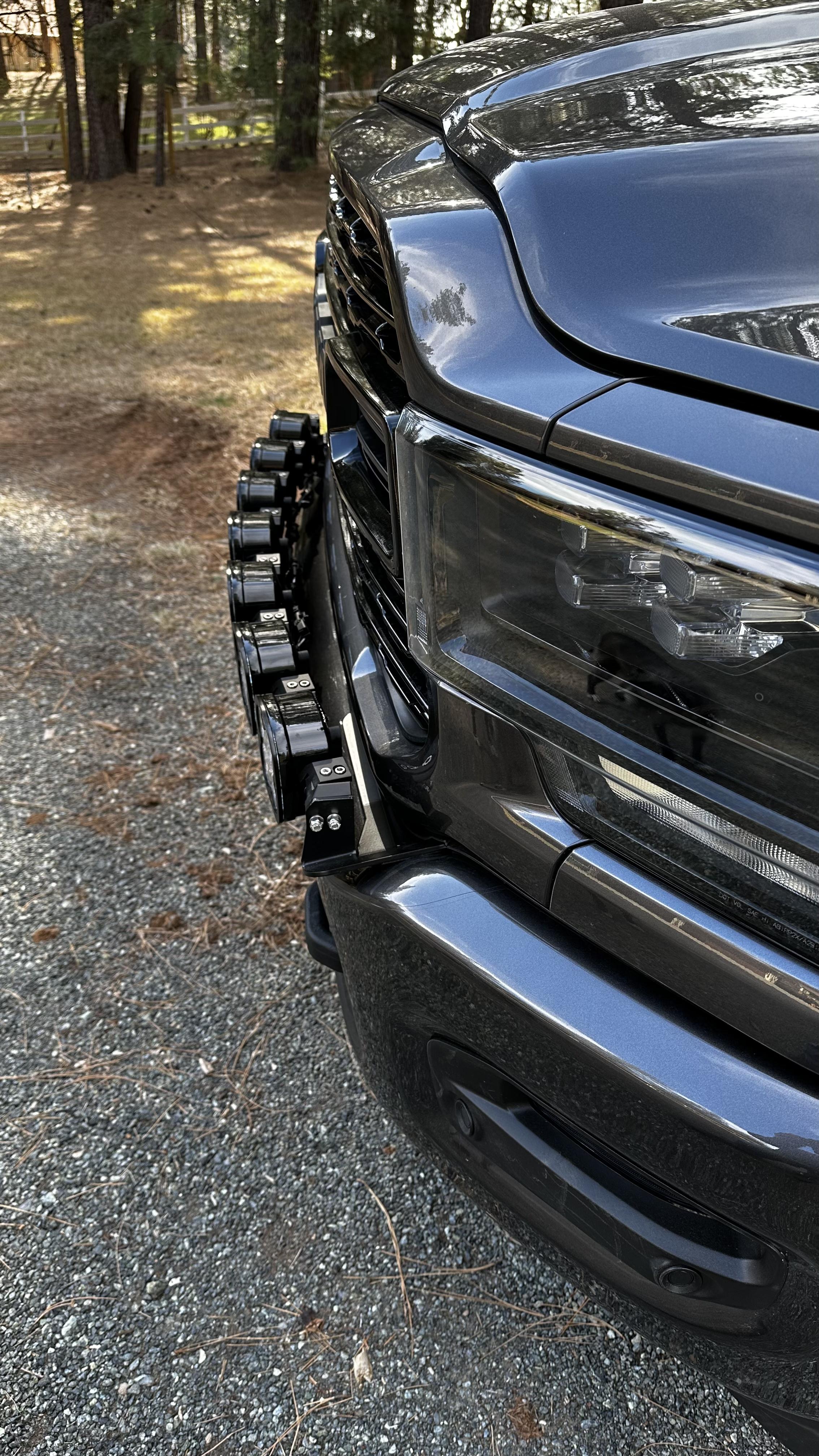

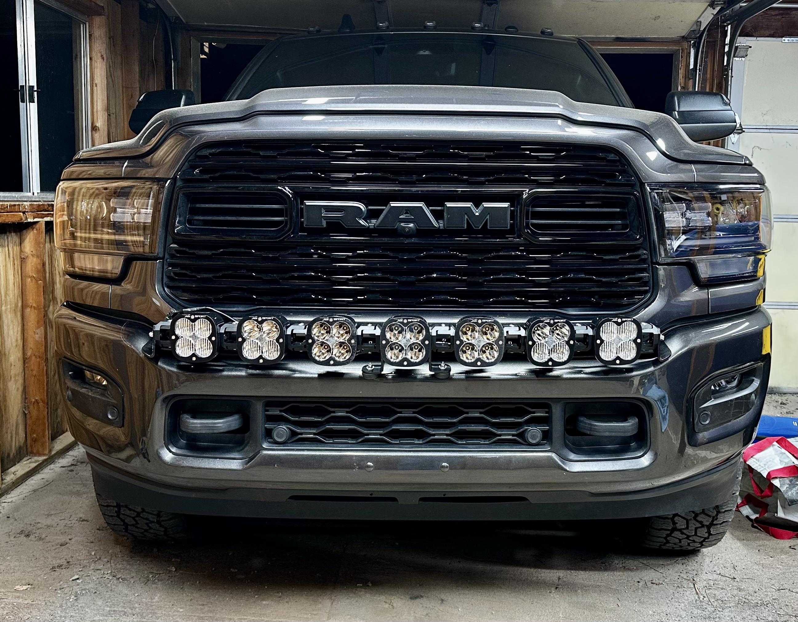

Finally got around to beginning this install. Today I was able to get the lights mounted and hopefully tomorrow I’ll wrap it up with the wiring.
Spent a little over 5 hours on it today in my garage. It does require removing the front bumper which I was able to do by myself but I did phone a friend putting it back on. The instructions have you loosening the lower balance but I’m not sure that is totally necessary. Those tow hook bolts take some effort too :-).

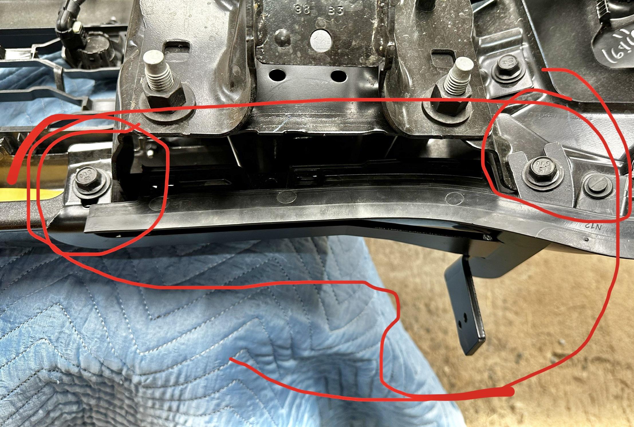

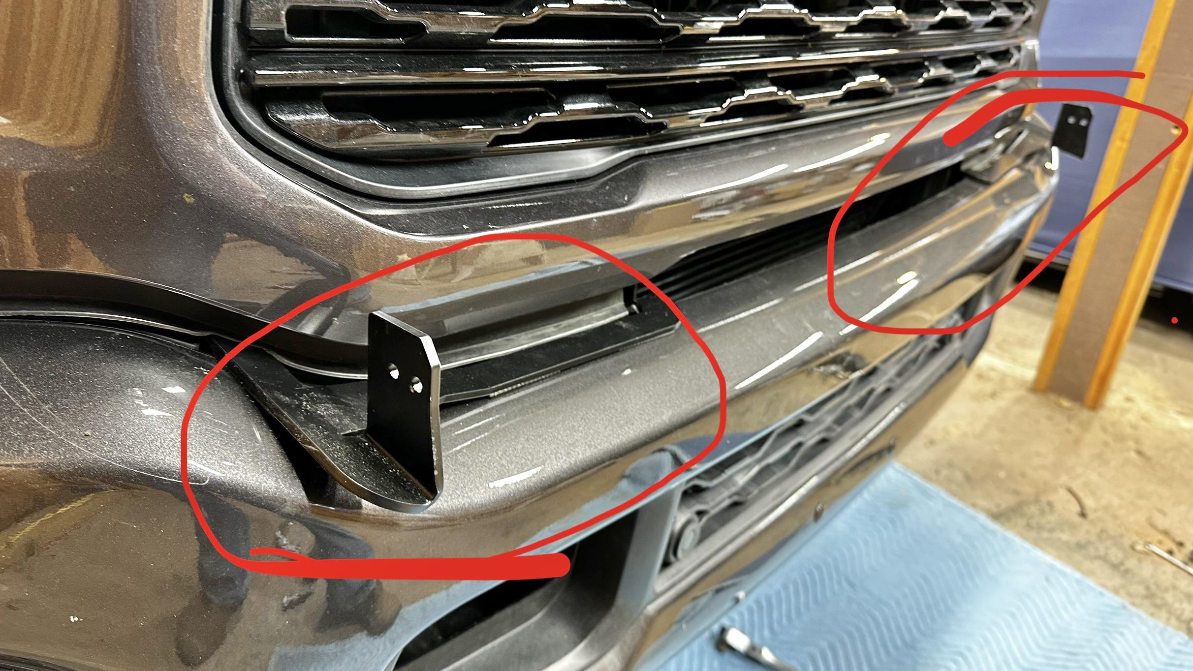

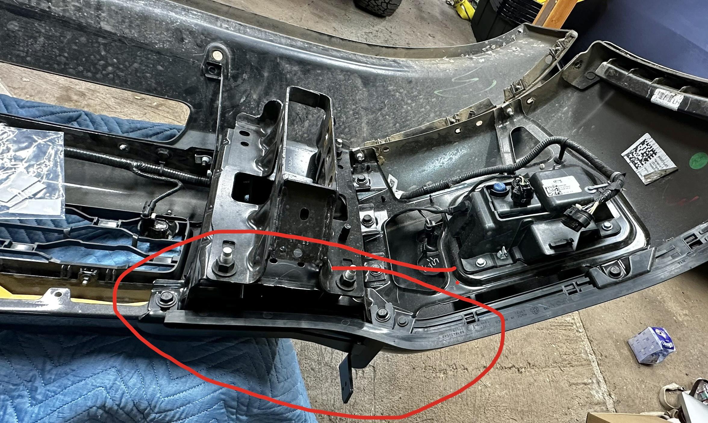

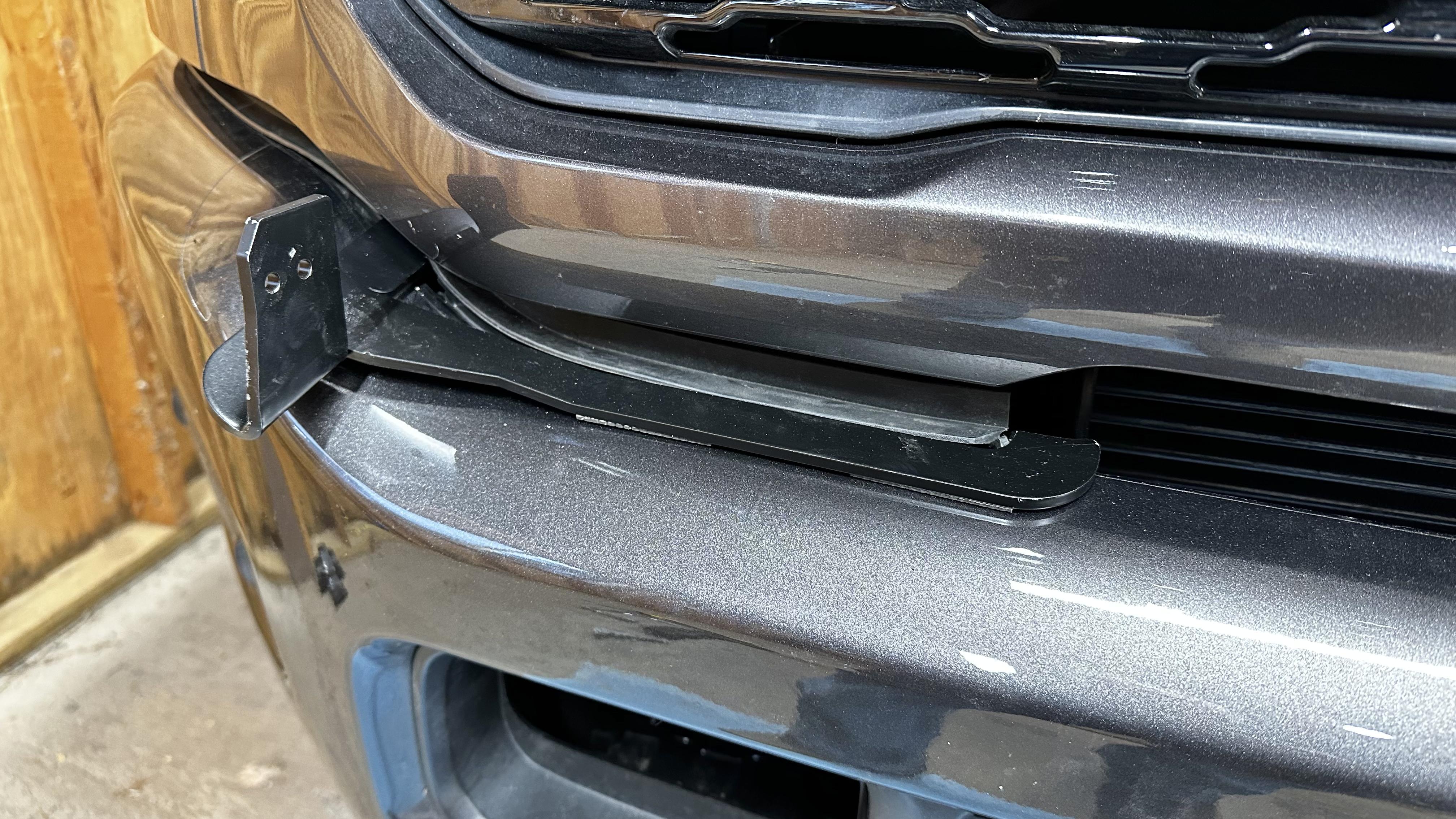

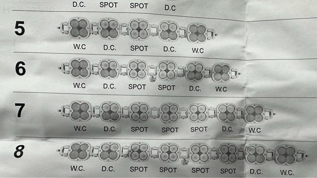

People were asking about the mounting brackets. The photos in the instructions were a little hard to decipher so hopefully these are a little better. The brackets mount to the bumper that you pull off using the two bolts I circled in the pictures. Took me about 3 hours to get the bumper off, mount the brackets then put the bumper back on. Another couple hours to get the light bar in place, a little challenging getting all the lights aligned and tightened as getting to the bolts with an Allen wrench is a little tricky.
