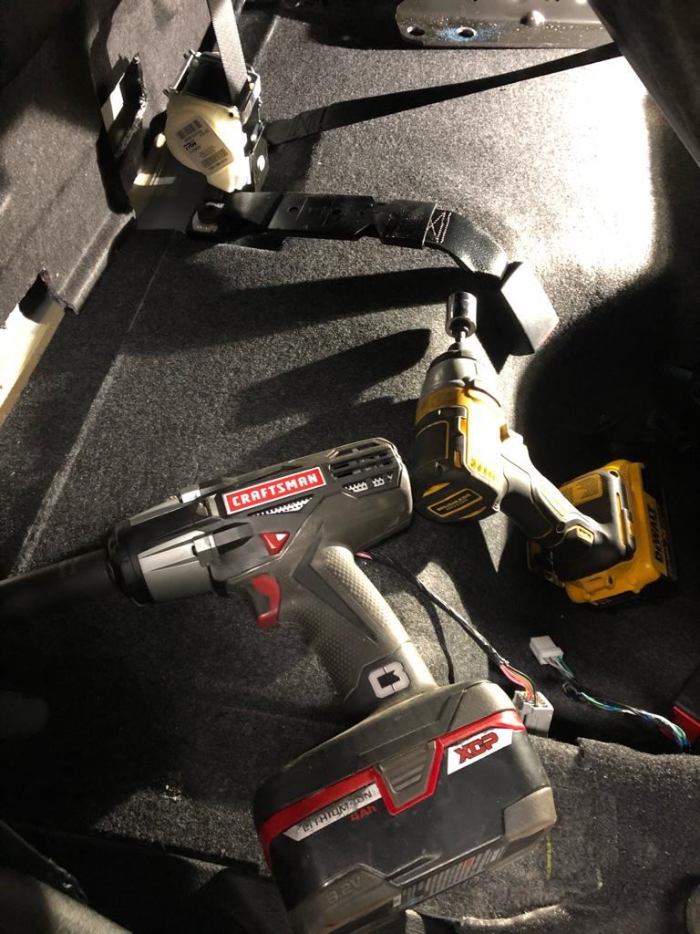

Pull the rear seat(s) out of a 19-20 crew cab.

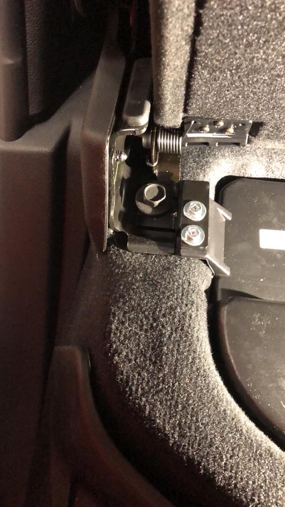

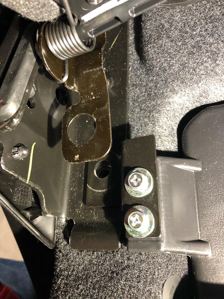

There’s (4) 18mm bolts and (2) 13mm nuts holding the long bench to the floor. The wife and I want to go camping and need the extra space.
The seat bracket bolts will need to be put back in as the rear holes are open to the road. The front bolts hold the subwoofer and fold-flat floor in place. Viola!

Once you have the floor bolts removed, lift up like @Phil T mentioned above and it will all come out together. If you search YouTube there are a bunch of videos regarding the folding rear seat mod where you can see how the backs are held to the rear of the cab, but don't have separate bolts.

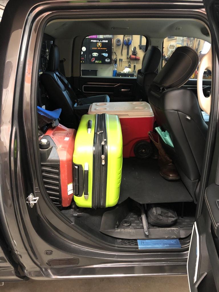

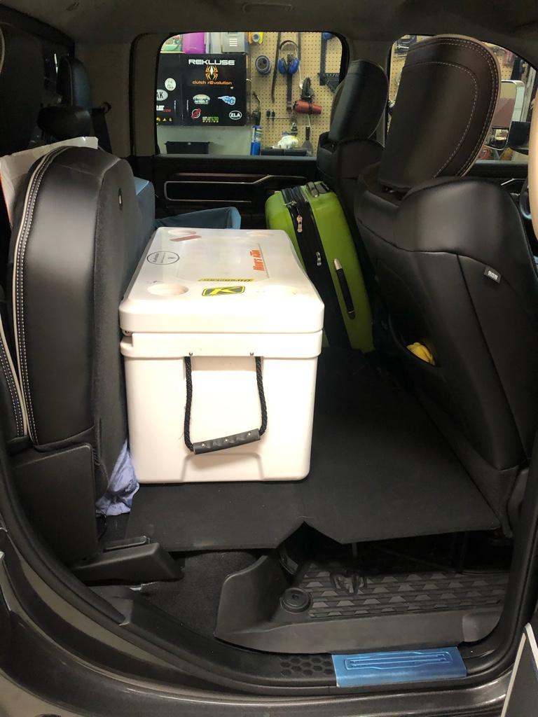

Now she’s got more room for another suitcase.
