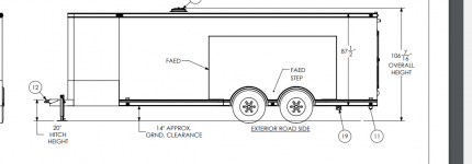

I vote for 7" because 9" might drag on the ground. I had a 18 3500 CC SRW 4X4 non air suspension and my 9" barely kissed the ground a couple times with the trailer hooked up. Trailer hitch height was 20" and I was a couple holes from the bottom on the adjustment on the Hitch.

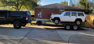

Hooked up my trailer today and snapped a pic for you before I loaded the crawler . My truck is stock suspension but I do have 35”s
this drop hitch is set to 6” drop and you see it’s still not level. The truck squats about an inch with the tongue weight and then it’s pretty close. The 8” drop setting is a hair low and the bottom ball scrapes on my driveway so I run it with the 6” setting.
sits pretty level when loaded and the truck squats about an inch
