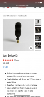

Tmr customs sells this guy works great no need to run extra vent hose i will never extend a vent line again after using these
Very interesting! I think I'm going to order this for the front diff breather so I don't have to be paranoid about suspension articulation.

I would be concerned with this in extreme changes in altitude...If you’ve ever seen a bag of chips at high altitude you’ll understand
it has an incredible amount of ventilation movement i have freinds out in the rockies high elevation with these that have never had an issue
My main concern is that if water does enter the diff then there is no longer anywhere for it to evaporate to as the diff heats up (no more vent line). That would also mean your diff seal has gone bad (to let water in). Also, make sure you install it in a way that the force of water itself doesn't pull it off.
Knowing that, I went ahead and ordered myself one and will install it.
Interesting, thanks for sharing!
My use is launching the boat in summer; if the water levels are low I can end up submerging the rear axle. I think this may be a great solution for that.

Idk what part of canada your in but if its in the gta area you can go right to their shop great guys to deal with
Thanks, but I'm out in SK. Appreciate the feedback as there are not a lot of online specialty shops in Canada.

Dont mess with the bellows they suck
