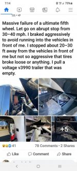

OK, since there are some folks claiming there's spreading of misinformation and false claims regarding AUH failures, here's a thread with everything I currently have available.
I will update as time permits.
Single event accident caused by broke AUH ball. Single vehicle panic stop. No other vehicle involved. No vehicle struck.

Someone tried to call me out for "spreading misinformation," so here we go.
It's obvious by the pictures. It looks like they used conduit as bracing. The ball snapping is shocking. It should never snap like that. Bend, maybe. Probably was made from recycled coors cans.
looks to me like your just spreading information lmao
that hitch doesn't look worth a crap to me and I never pull 5ver's. can't believe the ball sheered that way

I spoke to andersen this morning after seeing some of these pics. The tech i spoke with said the biggest issue in shearing of the ball is incorrect installation of the adapter. If the set screws are not tight enough or if the adapter is installed over the white grease gliding mechanism, it would allow the adapter to swing around in a harsh stop. That sudden movement of the adapter along with the weight of the trailer can shear the ball. If you look at one of the pics above, you can see the adapter installed over the grease glide plate. with the plate in place there is very little resistance holding the adapter in place.
