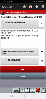

I’m looking for someone that has the 12” Uconnect 5 and AlfaOBD to check a setting for me for an upcoming project. I’m looking to see what this setting is set to-
This setting won’t show up in an uploaded BCM log, so you would have to go through the motions as if you were going to change it, then, when you press start, it will show the current status of the component in the description box. Then just back out of AlfaOBD instead of clicking next. Thanks.

I think this what you're looking for
So Jimmy, are the pre-22 12: screens 1920x1200 capable?
We’re actually messing with that as we speak. The old screen isn’t working with the UC5, and is also a different manufacturer than the UC4 screens (back to harman). I’ve got a new screen coming in tomorrow, and someone else is logging messages right now when the above setting is changed in a pre-22 BCM, and the messages aren’t changing back and forth the same.
