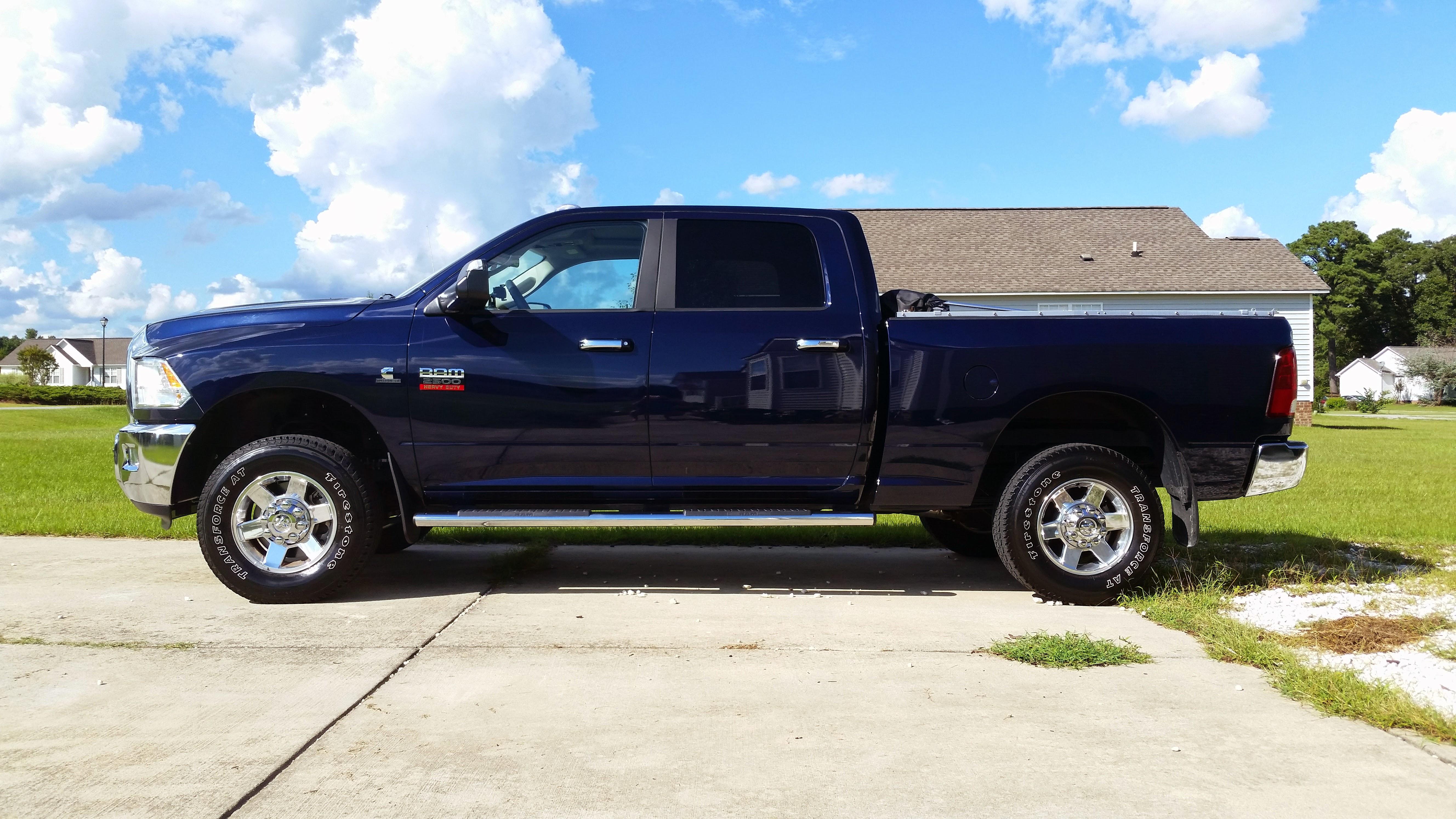

I lowered then rear of my '12 by removing the leaf pack spacers. I'm considering lowering the rear of my '19 too as it makes loading and unloading much easier. Another member pointed me to this place. I haven't purchased yet but the reviews I found online have been good. http://www.coilsprings.com

This thread reminds me of the ugly truck problem we have in America that nobody is addressing
I agree, that's a problem. But this is what I'm talking about...
Greg
Oh I know. I’m just a class clown. I wasn’t making fun of your truck or the OP
It's all good. I appreciated the joke. Also wanted to make sure anyone scrolling through knew what was actually being discussed
Greg
Dangerous as well as stupid looking. And in many you can get engine dry sump causing failures
The sump is at the rear of the engine where all the oil would go..... plus you would need to be almost vertical to start cavitating the oil pump
