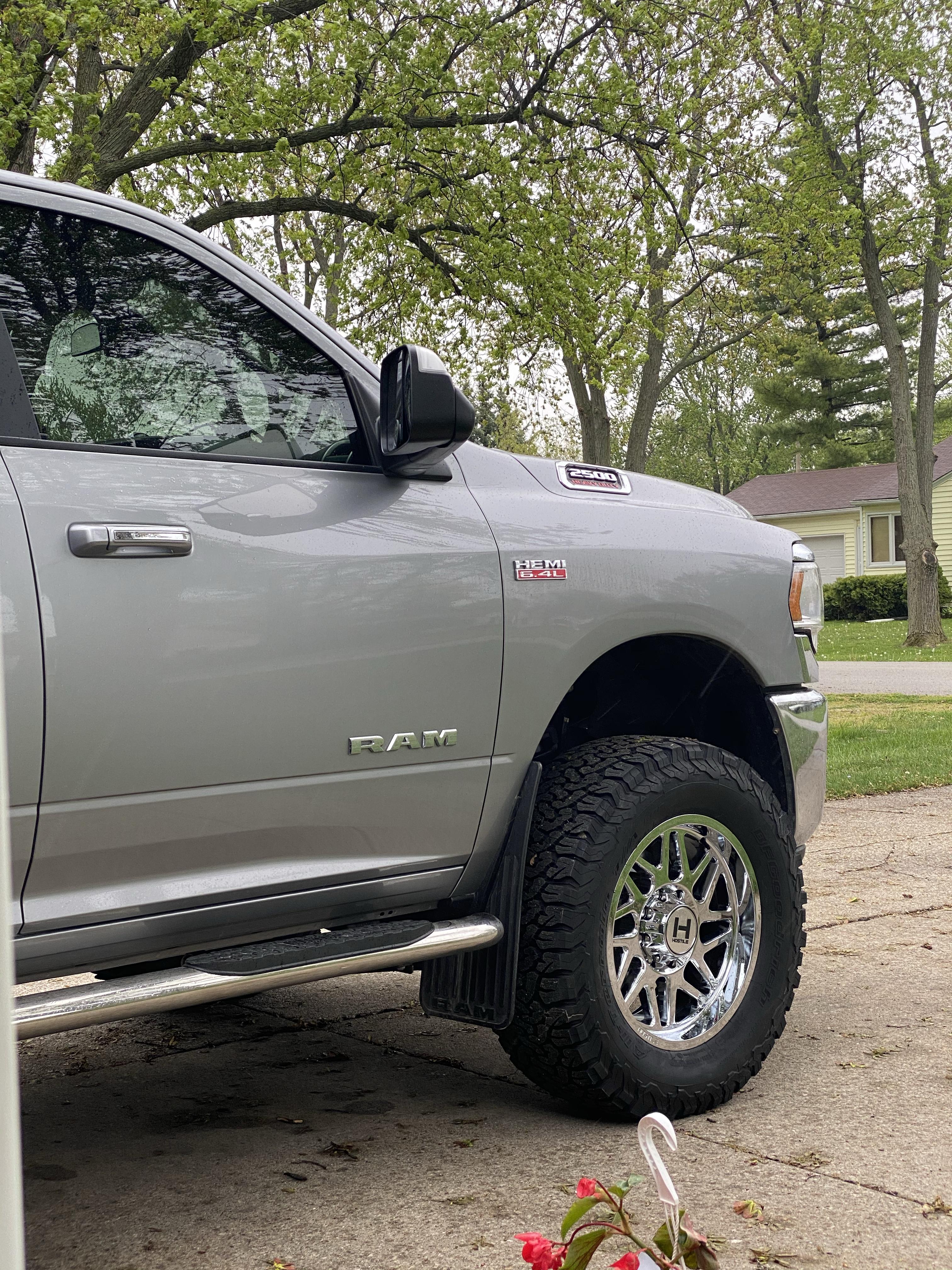

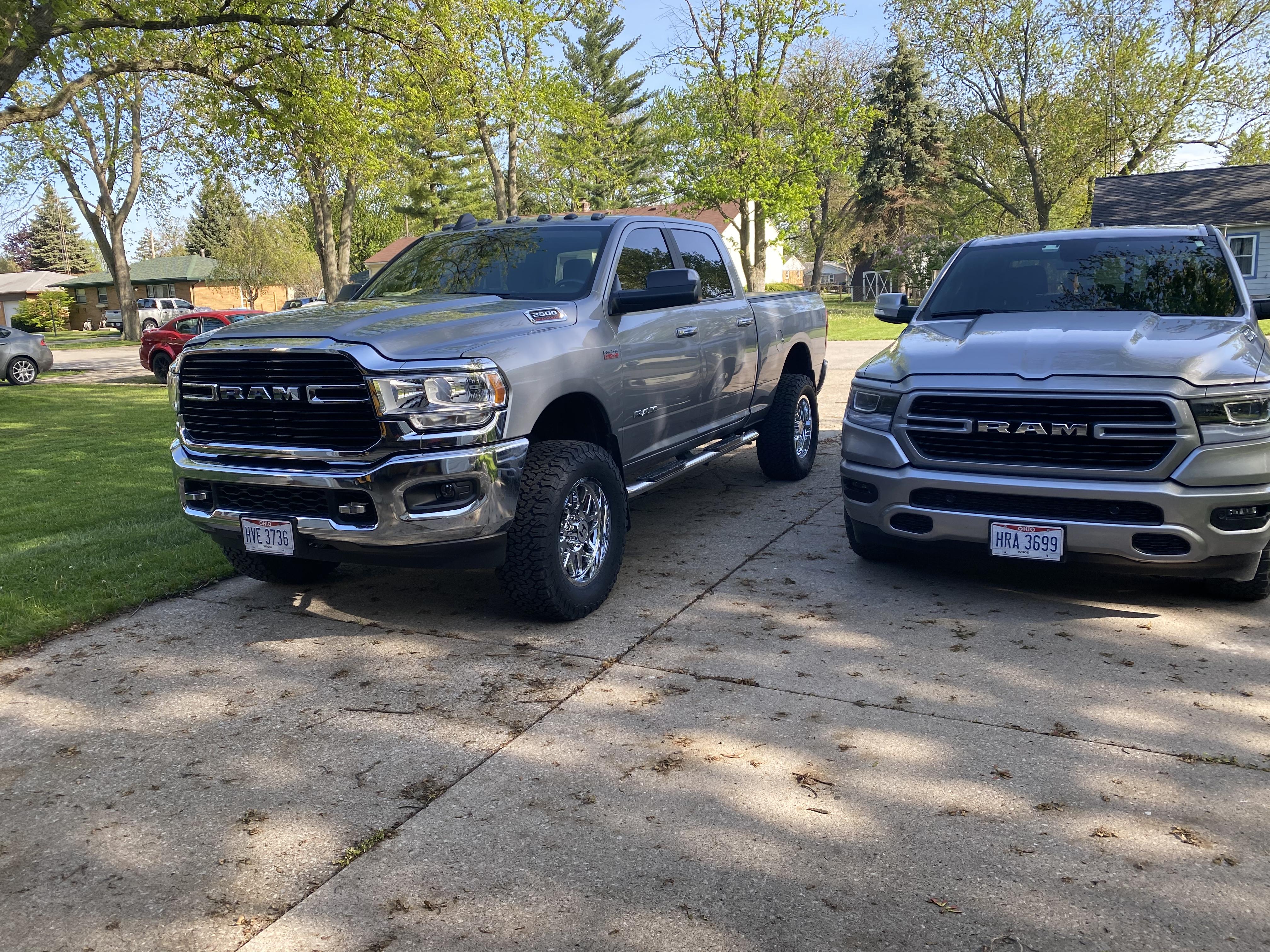

I have the Snow Cheif package. But I changed wheels and tires. 325/60/20 BFG KO2’s with Hostile Sprockets 20x9 0 offset.

How do you find the 325’s? Any material impact in your clearance? Especially when hauling?

They just barely rub my Mopar splash guards on tight turns. And I mean BARELY. Not even enough to make noise. Only way I can tell is it leaves a mark on tight turns. Forwards and backwards. I think without the splash guards it wouldn’t touch the fender liner. Offset is the key here. Any more than a 0 offset with these tires they would rub more. I think if I went a -6 or -12 or more I would have to trim. I freakin absolutely love these tires. Have them on both of our trucks.
And as far as hauling goes, I haven’t pulled our trailer with the wheels and tires yet. But the rears have a TON of clearance. So I do t think it will be an issue. These tires measure out to be 35.5” tall and almost 13” wide. I know you can do a 37” on the rear with no lift and have no issues. Check out CJC Off-road on YouTube. They have some videos on what you can get away with without trimming or cutting.

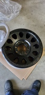

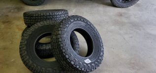

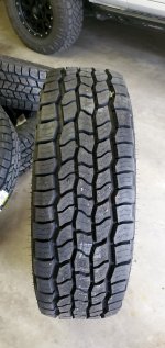

I went with Cooper Discoverer XLT LT285/75r18(35s) with Fuel Vectors in a +18 offset. Sorry, not installed quite yet. One could assume that a set of racing slicks would perform better than the Transfarces.
