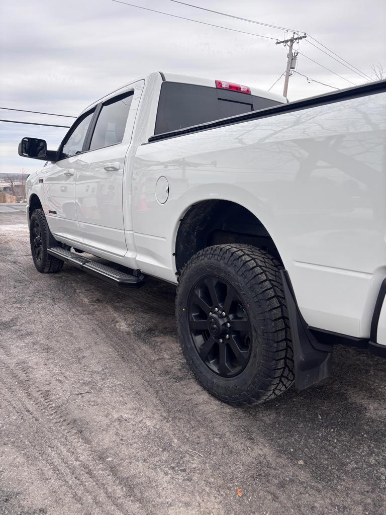

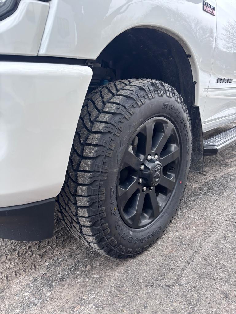

Skinnies installed. I have a whopping 20 miles on them so time will tell. First take is the truck feels much more stable. They are quiet and it still rides like a truck. I’m the dare to be different type and also didn’t want to spend $2k on tires hence the non-big name brand. They will likely have cracks in them before I wear them out.
275/65/20 Milestar Patagonia X/T
