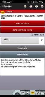

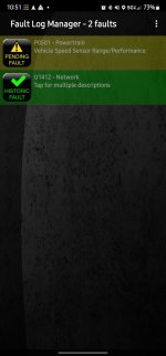

EDIT: I tried clearing codes again and after a few more ignition cycles the cel is off and no codes. Guess it needed more time to set itself?
Hi all, I got my speedo corrected, turned off the signature lights, and adjusted the tpms threshold yesterday. Afterwards I went through the three reset steps for abs, clearing dtc, and clearing roll info. I now have codes for headlights in alfaobd and a code for power train in torque. They remain after clearing codes. Any ideas?
