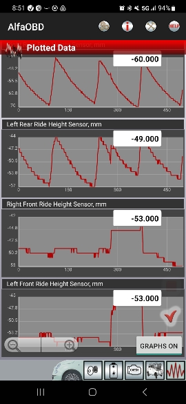

I had been dealing with a similar issue for 6 months and just found the issue on mine and it sounds similar. With my truck I would loose suspension on really cold days, when I took long highway trips (1+hours) or if it was under a heavy load.
My truck would hold air in normal, Offroad 1 and O/R 2. The truck would loose air in entry/exit and aero mode due to a leak in the rear suspension..
The suspension freezes in winter because all the nitrogen has escaped and the system has pull in ambient air, moisture builds in freezes. Alpha ODB helped me to pin point the issue. Attached is a screen shot of the truck in Nortmal ride mode then switched to entry/exit. You can see if loose air and refill. The air is leaking from the air blatter on the top where it rolls over. You need to cut the zip tie on the top of the protective cover and pull it down. Spray it with some soapy water and you will see bubbles.
Hope.that helps
