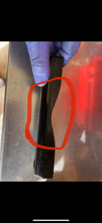

I just finished installing the 7500XL air bags on my 2019 Tradesman CCLB DRW 6.7HO. It has the larger AAM12 rear axle that comes on the HO engine and Max tow package. Come to the conclusion that many of the aftermarket suspension accessories are not really considering this axle when designing their products. For those who are going this route with the larger AAM12 rear axle tube, the kit that Air Lift recommends for the 7500xl bags (pn#57531) won’t fit without some minor modification. You will need to modify three of the provided brackets to fit this larger axle properly.
The slot on the top air bag bracket needs to be elongated to 1.3 inches wide otherwise the bolt holes on the upper part of the bumpstop frame won’t line up. This will prevent you from bolting the top airbag bracket to the frame. I first drilled a hole then used a square file to elongate each top bracket. Make sure you elongate the side I circled and towards the bend.
Post use of square file to elongate slot.

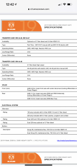

The 12" AAM comes on any HO including the SRW.
I believe the 12" comes on any DRW.

Pretty sure only the 3500 SRW and DRW with 6.7HOs and those with Max Tow option get the larger AAM12 axle. All others are the AAM11.5 axle. However, I could be wrong.
This reference tends to align with that
