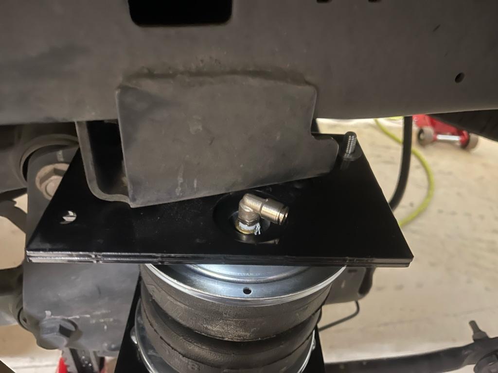

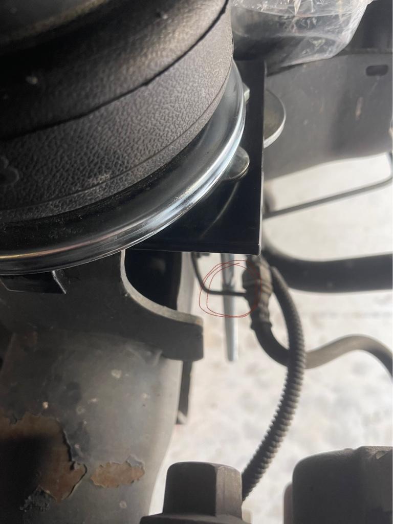

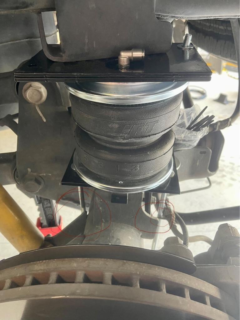

Has any one put the air ride 5000 air bags on their 2021 limited mega cab 2500? Has to be 2021 or 2022. There was a change so don’t care if it’s a 2020. Trying to see how you did it or if I need to just return them and get pacbrakes air bags.

Why do you say there was changes? I took a set out of my buddies 18 and put them on his new 22 for him no issues

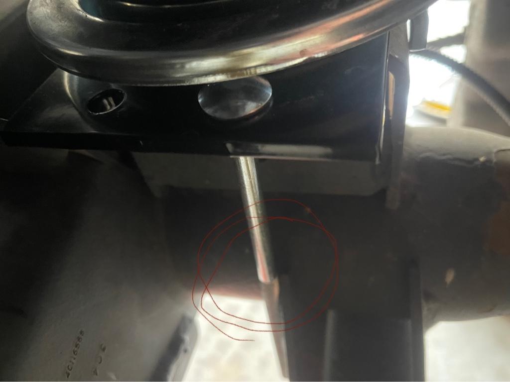

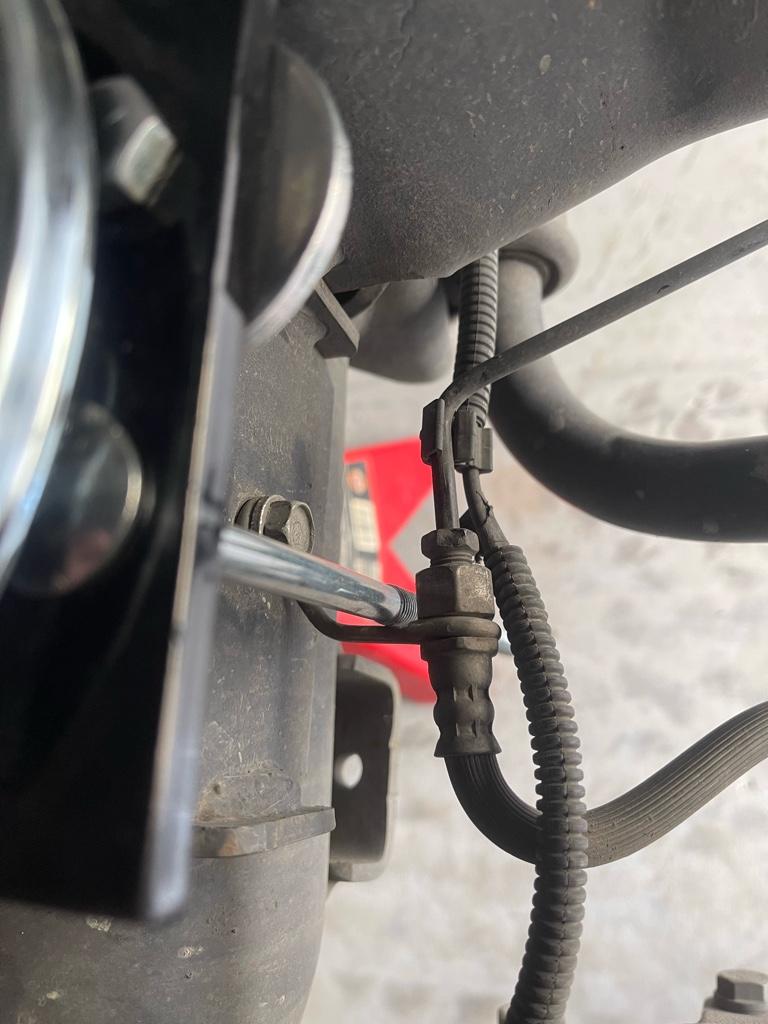

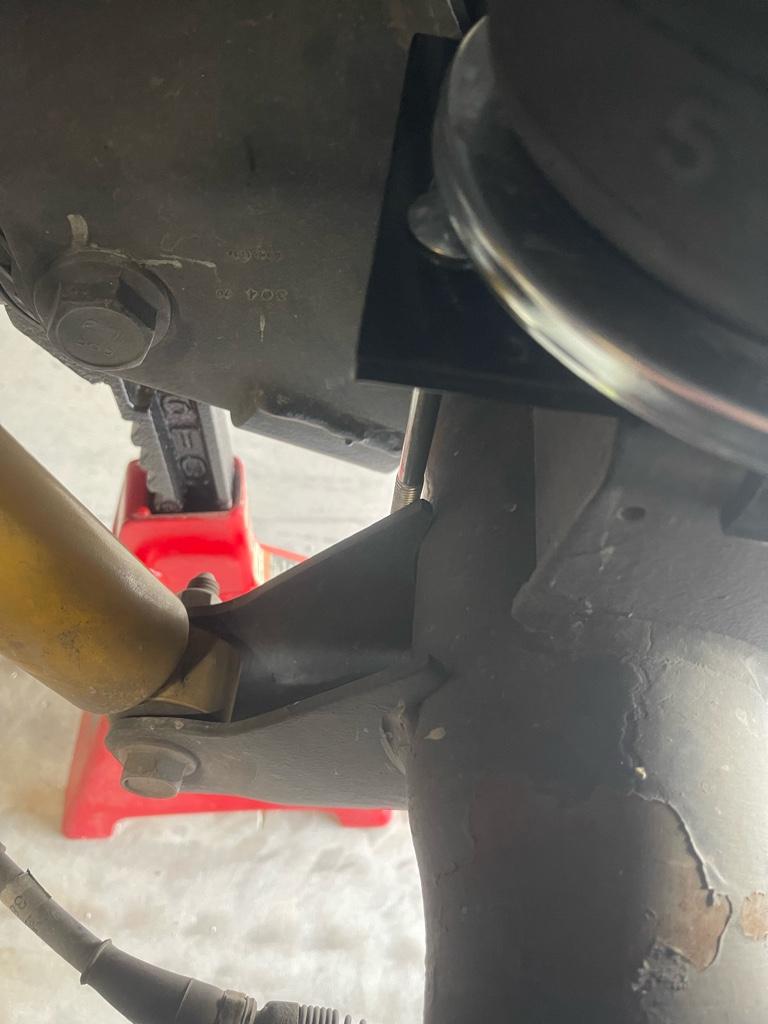

There is a brace for the brake line that the back long bikt makes contacts. The front long bolt can’t be straight due to the shock tower bracket. This is the left/driver side.

The bolt touching the brake line bracket is not an issue and there should be enough adjustment to get the bolt on the front side straight, that being said i would get the day star cradles instead unless you never leave the highway or put the truck on a hoist
Looking closer at your pictures im pretty sure you have the bottom bracket backwards or upside down
Yep your right. I had the bottom bracket flipped the wrong way. They are on and went for a test drive. The bottom bracket (under the axle) is too small. The axle size changed but not sure if that’s a 2019 thing or 2021.
