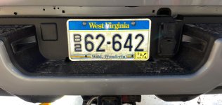

So, I've got the bags themselves installed and looking good. I'm ready to run the air lines to the rear bumper but thought I'd draw on the pool of experience here first.
So those that have installed the Schrader valves on the bumper, where did you put them?
I've considered replacing the license plate screws with the valves, but not convinced that's the best idea. I'm thinking the two square holes below the tailgate would be best, as long as there's no interference with the tailgate.
Thoughts?

The little square on the bumper was an attractive spot but once I pulled it out I could see it didn't really have the real estate available to support two Schrader valves.

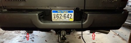

I ended up mounting them to the bumper, but underneath in the black plastic part that holds the assist sensors, with one on each side. This allowed me to run the tubing down the inside of the frame and straight out to the valve(s) with a minimum number of bends. If, at some point, I decide I don't like them there, the holes left behind will only be visible by laying on the ground under the truck. Plus, being plastic, there's no potential for rust to form around the drilled hole.

I investigated using the license plate and did remove it. The bottom holes won't work because that's where the plastic part of the bumper attaches to the metal part. Plus there's a lot of webbing on the backside in that area. I would have had to drill out the holes in the license plate and I was concerned there might be interference issues with the spare tire. If they had 90° Schrader valves, it would be a lot easier to install in many places.
