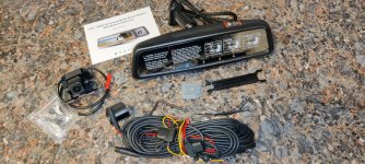

Included in the packaging is the mirror monitor, cables, spare window mount, zip ties, cable cover, and the rear view camera. The mirror is almost exactly the same size as an auto dimming mirror, slightly larger than a manual dimming mirror. The mount adjustments are same as OEM and very sturdy.
This was very easy to install with the tool included to release the set screw on the original mirror and slide it upwards off the mount. then adjust the LCD mirror to about match the factory position and slide it onto the mount. then route the cable up into the headliner. A more in-depth installation and operation will be posted soon. The camera has two mounting options with various angles of mounting available with each option.

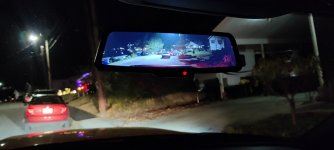

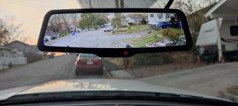

The mirror is controlled through a touch frame design, so you do not have to get fingerprints on the mirror. The angle of the camera view can be adjusted for the front and rear camera, brightness, and recording modes. The camera does really well in daylight and is enough to see well at night.

yes, it is on all tie time just like the OEM option, it gives you an unobstructed view out the back of the truck. that you normally get from the rear view camera. this is also a DVR, so it records all of the time and locks file on impact. the display is actually annoying if setup with the reversing switch since it is constantly switching between front and rear cameras, I leave it as a rear view camera all the time. you can manually turn it off, I guess but you will not have any rear view mirror, that I use to verify if cars are near me changing lanes, merging on interstates, or tailgating me to allow me to give more space ahead of me. I find myself using the digital rear view mirror even more than the useless oem mirror since all I could see was the back seats before.

It has no noteable delay, and at night, you can see the footage of my review. It does well. In dark woods you would need backup lights to use it, but it would really help with cap visibility.
