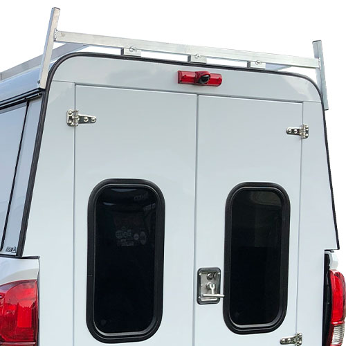

And I mounted my tailgate camera using this housing:
