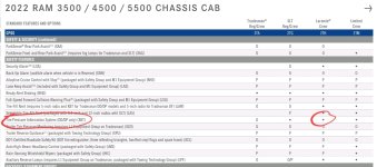

Looking at the standard features for the 2022 it says that TPIS is standard on Laramie DP's (5500's)

That's interesting. According to Ram TPIS should have been standard on the 2022 Limited as well.
Yep. Maybe it got nixed by the bean counters, but I am not convinced it ever came on any of the chassis cabs despite the mentions.
I'm not sure how Ram hasn't been sued over this. They still clearly state that it's standard equipment on 2022 Laramie and Limited 4500/5500's. I'll have to figure out my sensors. I think I have steel inner wheels. Also the outer sensors you the listed are now discontinued.
Someone with a Tech Authority subscription could work it out for you as well as if there is a new part number for the outers. I don't have an active one at the moment unfortunately.
There's a disclaimer on all of their documents that says that specifications, features, and options are subject to change without notice. 2022 was the year that almost every truck delivered missing something, due to parts shortages.
You'd think anything missing should be listed on the window sticker.
