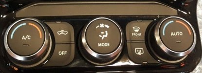

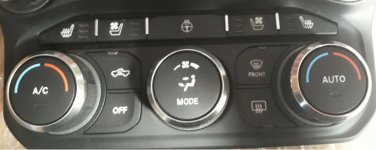

Do you have Auto climate control? I updated my bezel for ATC and have Heated/Vented seats & Heated Steering, which I did not enable as I don't have them but, willing to swap with you.
The climate controls are an individual unit though, only sold as the whole bezel!?
1st pic = I have
2nd pic = I'm looking to trade for

Nope i also wish I had that. Thank you anyways!
