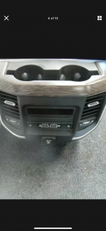

I’m on the quest of swapping my rear console of my center console to add the factory USB and found the below pictured being offered with the inverter outlet. My truck doesn’t have any inverters in the console or bed. This that I’m getting is coming with the factory wiring harness as it’s the whole console itself. What do I need to add to make the inverters function? Are they just plug and play?
Any information would be helpful. I found this part, 68302053AE, which is listed as a power inverter module. I know these trucks have a tendency to come with things in wiring they don’t have options for but I wouldn’t think it has this module with no inverters from factory.

You’ll need that inverter, and it mounts behind the radio. You also need to check behind the radio to see if these two connectors are taped up somewhere

No mentions of any inverters and the one guy who added the console with the rear inverter has never replied back.

I will check when I get home for these connectors. Hopefully they are there. Thank you for the information.
EDIT: I pulled out the radio bezel I didn’t any obvious taped up unused connections. Is this still something that can be added?
@Jimmy07 this is all that I’m working with wire/plug wise. I haven’t seen any unused ones in the dash.
