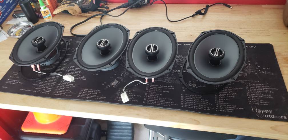

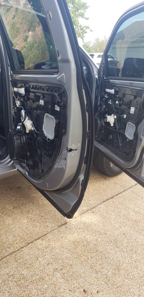

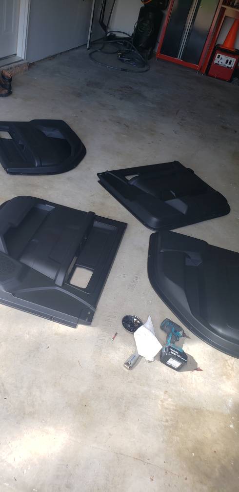

I changed my dash speakers out and it really helped round out the sound. I assume the ANC amp does not output to those speakers. It sounds good but I am thinking about upgrading the front and rear door speakers. I guess I will have to address the ANC if I do. I have the Alpine system so I believe my ANC may be under the seat? I haven't really looked that far into it yet.

So....maybe I browsed past it but anyone with the Alpine system notice a difference with this? I like the sound but if it changes things for the better I am in.
