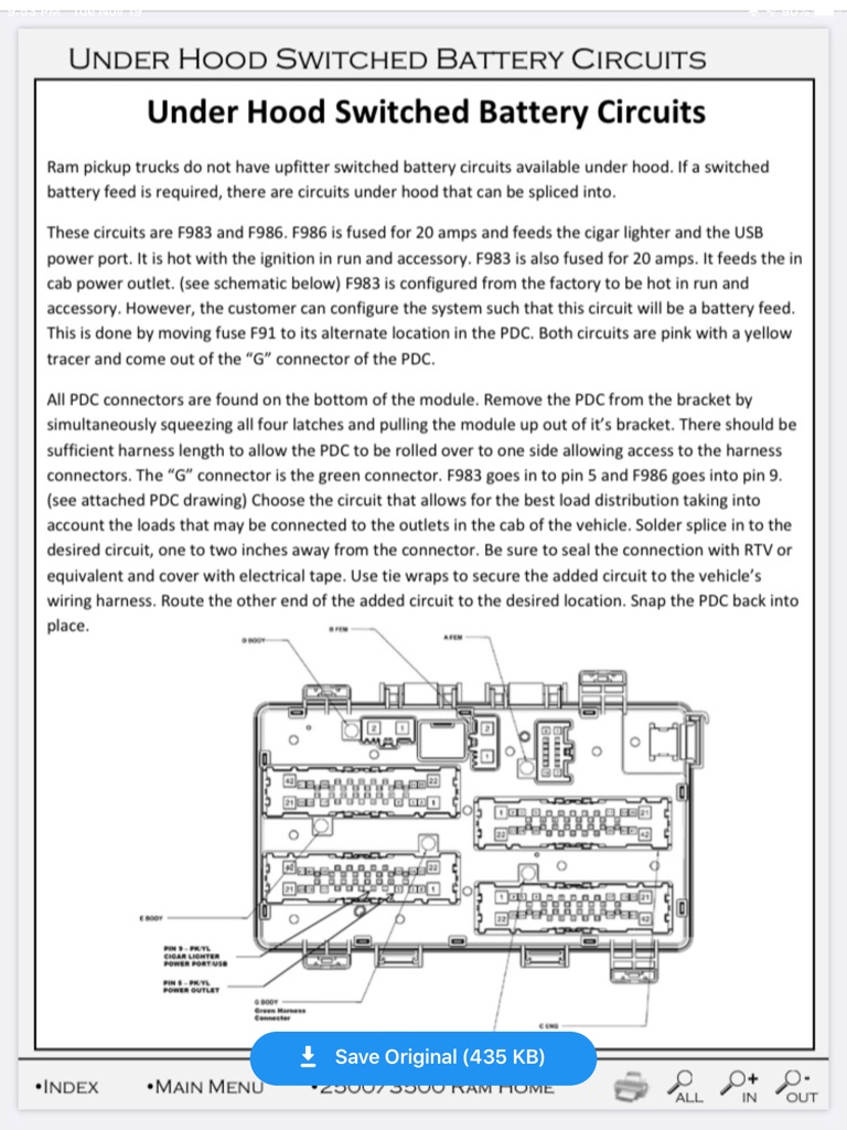

Does anyone know of a good under hood location to access accessory on power? Going to hook up my Trigger module. Thx
Grabbed this from another thread earlier, it should answer your question.

Thank you. When I was over on the 1500 site someone told me about an exposed stud by the fuse box. Not sure if the HD wiring is similar. Was going to get a new Rebel but plans switched. Anyhow.... they seem to have booted me out of 5gen, not been active enough I guess.
