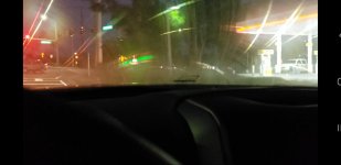

My 2019 3500 is having an issue where the AC is coming from the defrost in all modes. To clarify, when in vent mode it seaps from the defrost and constantly fogs up the windshield, the longer i sit or drive the worse it gets. If I turn the wipers on it gets worse much faster. If I put it in foot mode it is substantially worse.

I hear you, but my issue is not moisture on the inside of the windshield. The cold air constantly blowing at the base of the windshield is creating a layer of condensation on the outside of the glass creating a visibility concern. The end game here is to stop the flow of cold conditioned air to the windshield when not required. I know how to use the defroster and how the ac system works. I also know that it is not something that is designed into a vehicle because it creates a major safety concern (poor visibility out of the windshield).
Ok, so the temperature of the windshield is getting below the dewpoint temperature. I have seen this too on a rare occasion, but I don’t live in a humid area so it doesn’t too often. Sorry for the confusion.

Correct, it "seems" to be a simple mode door problem. And the cooling issue is a blend door problem, this seems to be confirmed. I say that because of people clamping the heater core supply line and the problem is gone.
