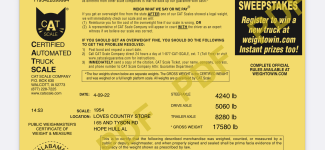

Family of 5 here, my setup is similar to yours, my 5ver fully loaded is 10k, pin weight is around 1,700 to 1,800 lbs. Truck pulls the load, it works, sure. It does not struggle. From what you described, I would be honest about what kind of grades and how often you’re gonna pull them.
Truck specs in sig.
5ver: 2022 Grand Design Reflection 150 Series 278 BH
Factory specs:
Dry weight : 8,295 lbs
Gross weight: 10,195
Pin weight: 1,338
Fully loaded across CAT scales I had a little over 1,700 lbs on the pin, 8,280lbs on the trailer axles, right at 10k total trailer weight.
Oh ya, about 7.5 mpg on that trip (drove the posted speed limit, mostly interstate).

We love it so far, brought it home 12/20/21, 4 or 5 trips to date. The quality seems pretty good for a house on wheels, none of the manufactures are what I’d consider great. Having previous owned a couple of nice Flgstaffs, this Grand Design is on par.
I will add, my truck does not need airbags for this camper. That pic above is @ full load after we fueled up, she sits darn near perfectly level.
Snap shot from the scales on the way home after fueling up. Pretty much identical load on the return trip as when we left home, maybe even a smidge heavier.
