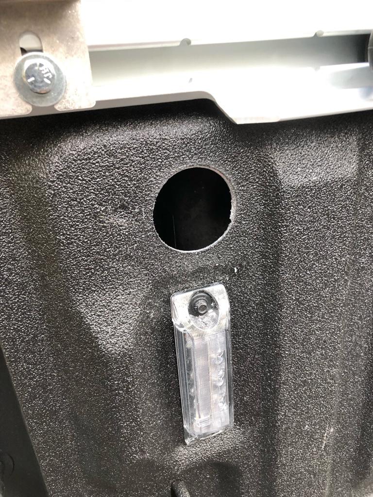

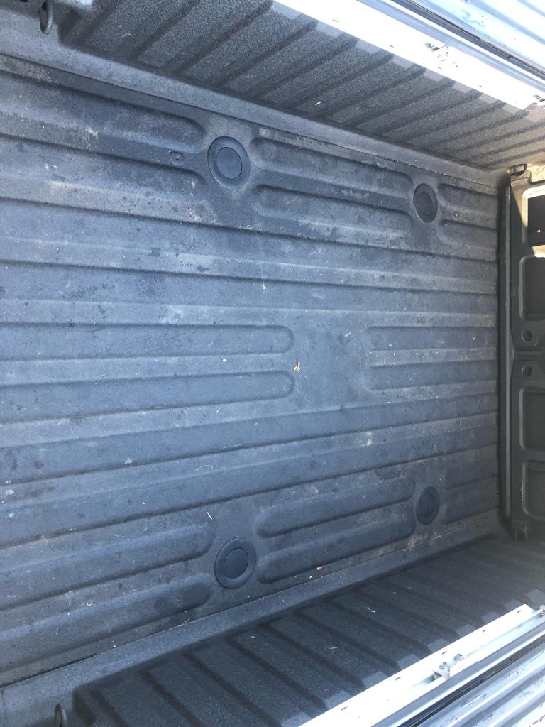

Finally got around to installing the factory puck system in the Rambox bed and a 7 pin. I would recommend going a little bigger than a 3-1/2 inch hole saw that the directions call for. 4 might be a little big but something in between would have been better.
