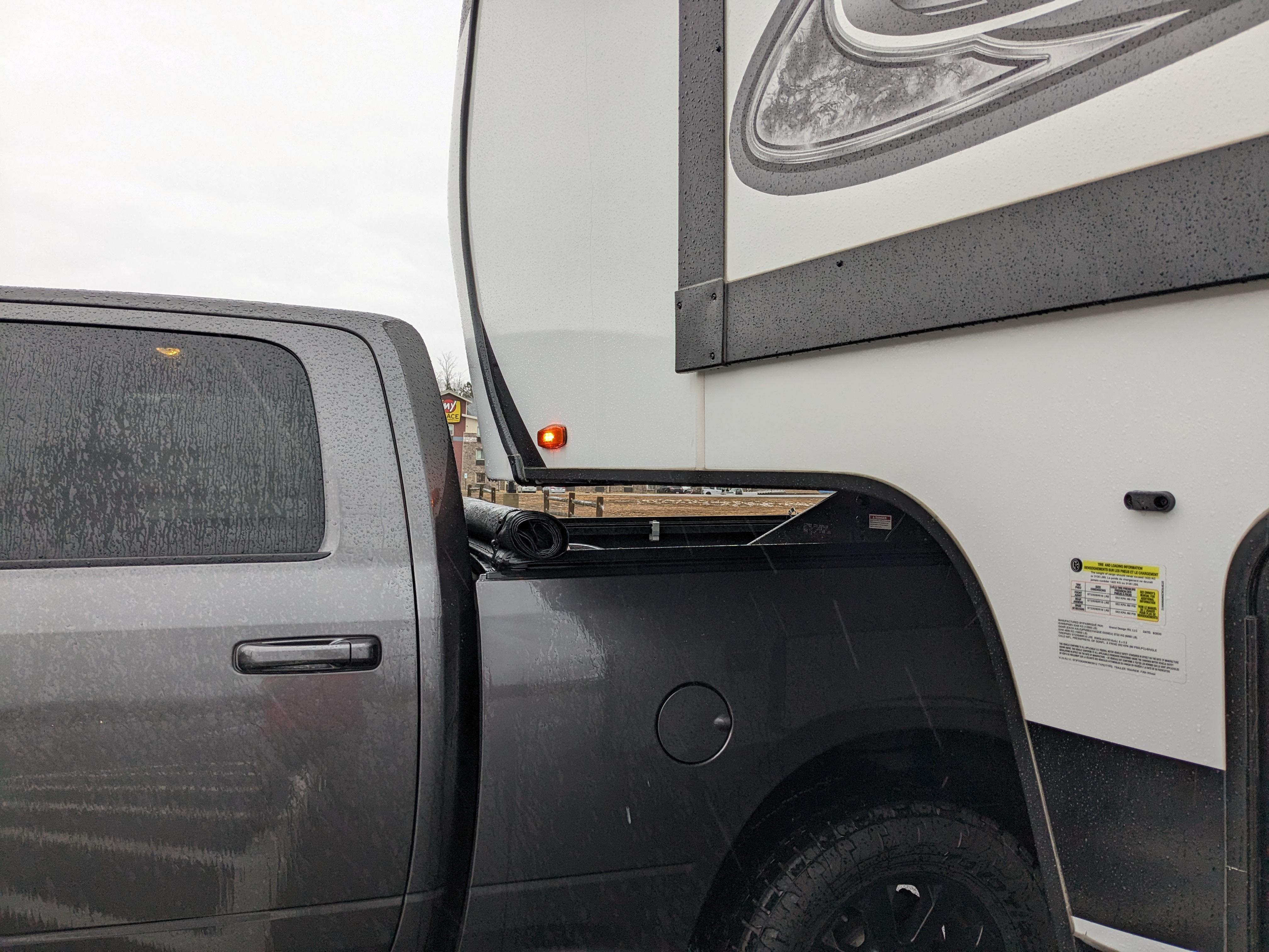

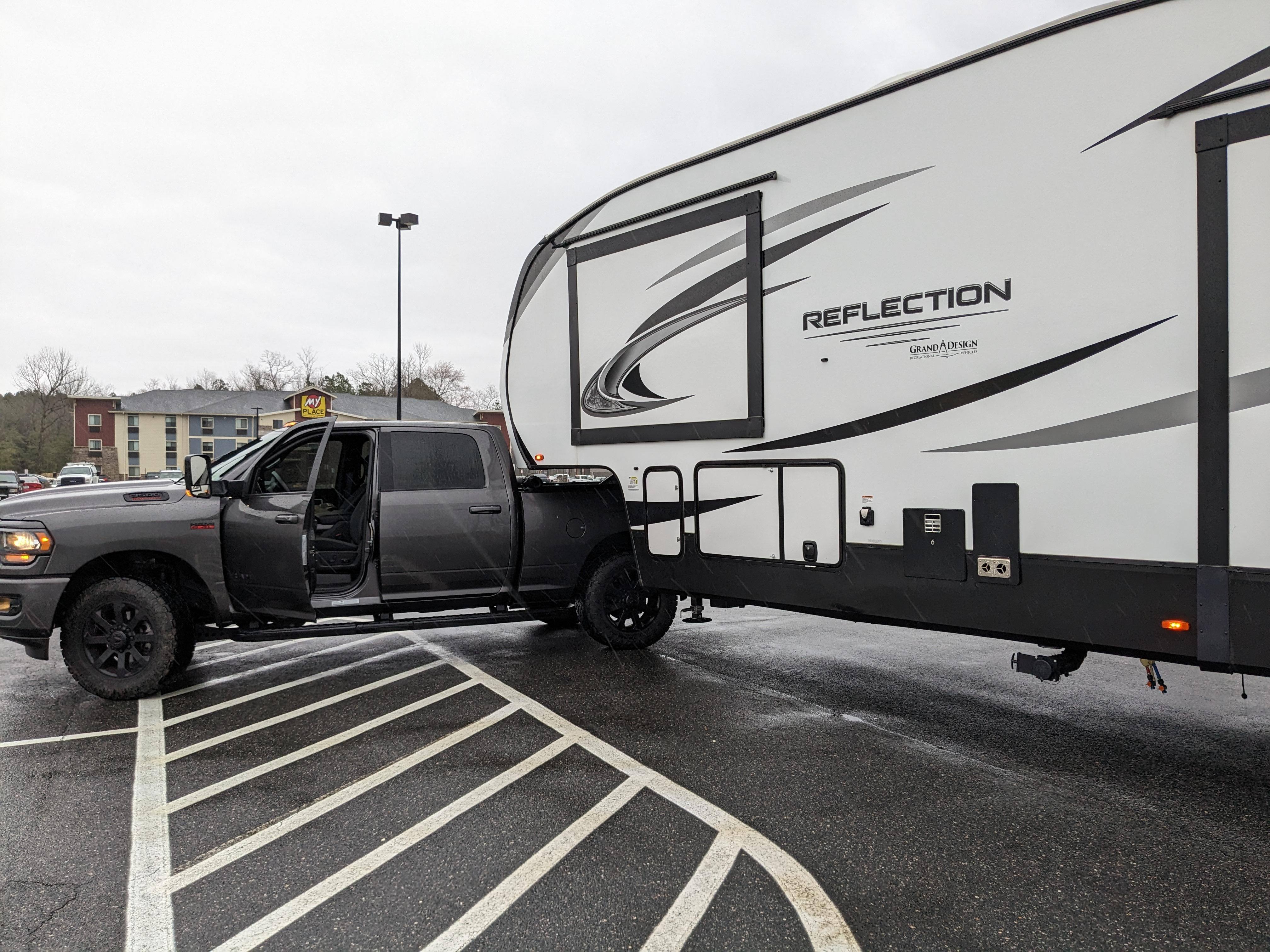

Well I got a ‘22 3500 mega srw with an auto slider pulling a ‘22 Montana camper. Here’s me at maybe a 55° on day one testing the waters. After seeing the clearance with the slider I haven’t looked again while backing up and maneuvering. You can see distance from cab and how much it’s slid at turn. Without a slider to me it looks like the odds of hitting are pretty high but I’ve had nothing else to compare to so it all I know.
Got the same truck. Exploring options. Looks like you have a Pullrite Superglide. Any reason you chose that over a Demco autoslide? I'm not dissing your choice. Would love to hear from an actual user versus the manufacturer's competing websites and videos.

Long story made simple. I found it on Craigslist for a killer deal and pretty much brand new, I think he towed twice with it. Too good to pass up and it was the hitch I wanted but no one sells them locally around me which had me contemplating. But the guy sold it cause he traded his mega in for a long bed dully otherwise he loved it and now had no use for the sliding hitch
