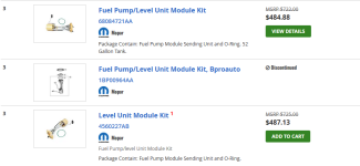

I have the Titan 55 gallon tank in my dually long bed. At least that is what is was labeled when I ordered it back in 2020 after buying my truck that year. I have often wondered if replacing the fuel pump sending unit from the stock 32 gallon tank to the 52 gallon tank would make a difference for the DTE and fuel gauge reading correctly. They do have different part numbers. My guess is the 52 gallon tank make go deeper into the tank and have a properly calibrated sending unit. I remember when I pulled mine from the stock tank it sprang up a bit. But when I placed it into the Titan tank, it barely needed to be pushed down into the tank.
Below is what I find on moparamerica for my 2020.

This is a good idea.
