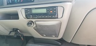

Brewbud, I did the same on my old F250. But I'd like to not do that this time. I had to put a reinforcement plate under it on the inside, then tear out the head liner to run it to behind the back seat where I had mounted the main radio. I have a remote head Kenwood set up so mounted the head unit in the dash cupholder.

Yep, had a 110W Kenwood that my buddy set up and dialed in. About 115W output. Talked to my buddies 50 miles away in SOCAL thru some mountains.
Original dash. Slide out cup holder and trash bag holder underneath.
Radio head unit mounted in place of the slide out cup holder
Trash bag hook turned into a speaker for the radio.
Main unit behind the back seat.
