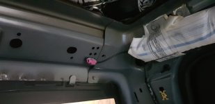

I belive you, kinda funny, my 2015 3500 has the wire, even though it did not have the camera from the factory. The Fakra connector was about a foot away from the CHMSL and ran down the C-pillar. (see attached pictures) That is a 4th Gen truck. I did swap in the LED CHMSL with camera but never connected it, as I ended up putting a GFC Platform camper on it.

Seems like every truck is different. I was actually surprised to see the FAKRA connector on may 2015 Laramie 3500. You wouldn´t think they make so manny different wiring harnesses, but maybe they actually do. Interesting, that you seem to have a digital camera in the CHMSL. There is also a version with just the FAKRA conenctor. That is what I have. Looks like your CHMSL but the camera only has a FAKRA connector, nothing else. That also plugs into the 8.4" NAV one without pinning anything else. So it seems tehre are different LED CHMSL with camera too.

I don't think that is the camera wire. That is most likely a GPS Fakra connector, as that aligns with the old location of the GPS antenna.

Hm.... I hooked up the wiring to the light to make the CHMSL work and the cargo lights and if I recall correctly, the Camera had a seperate connector, not part of the CHMSL connector. I would have connected it if it had not missed a food between this connector and the one on the cam. But I am 100% sure that there was a seperate connector on the cam in the version I have. But they also have 5 different part numbers for the same CHMSL with cam. Maybe I got a weird one, but it did not have a combined conenctor like the one in your video. With the GFC on it I cannot pull it back out now to take another picture. My GPS antenna is in the front between the cab lights.
Maybe because it is a 2015 (the weird year) they had wiring not common on 2016 and up....
