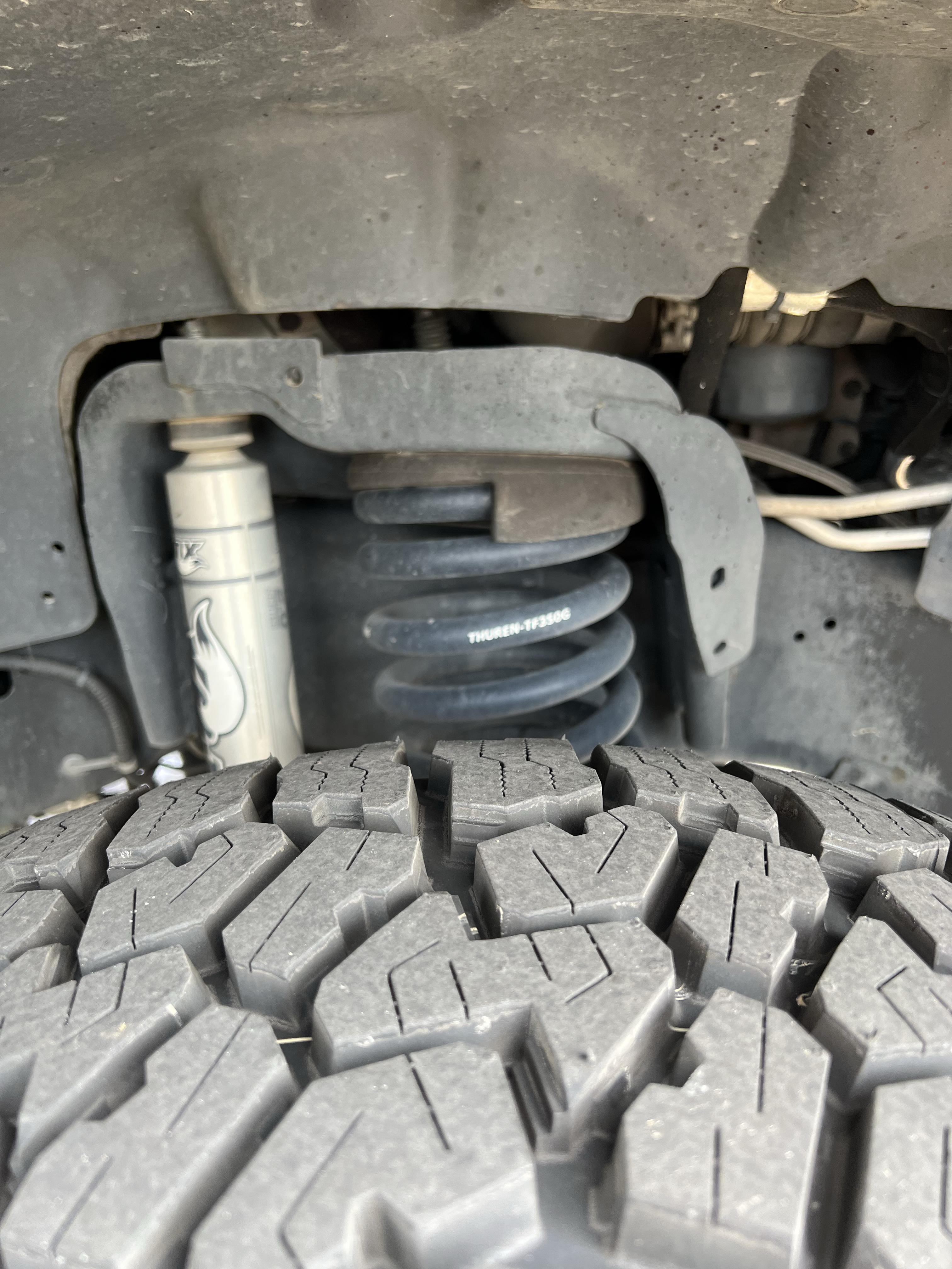

Update: it appears one side is closer to the east Of the fender/ wheel well than the other. WTF? I am bewildered.
To further complicate things, it appears the coil has slipped on the drivers side. Upon reviewing Carli’s site they speak of this and recommend the PW isolators. So, those have been ordered and a thuren track bar. Going to get all this installed, get the truck aligned, and see where we are at.
This is frustrating. It’s a leveled truck. I’m not running anything extreme and I’m shocked even with the slipped coil to have one side closer than the other and have any rubbing.

So…i take a ****load of pics as I work on stuff. After referencing pics from the install, it appears the drivers coil was always pulled forward. Not that it’s right..but I overlooked it. That’s what I get for a winter install trying to do it fast after work in the garage

I checked the cam bolts and one seemed to be off from the mark on the bracket that I assume was made at the factory. I adjusted it back to that mark. I ordered PW isolators, and a Thuren trackbar. Once I get those installed I am going to take the truck in for an alignment.
